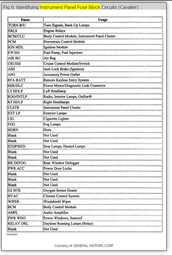

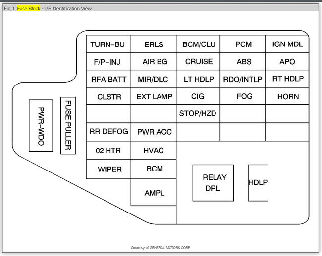

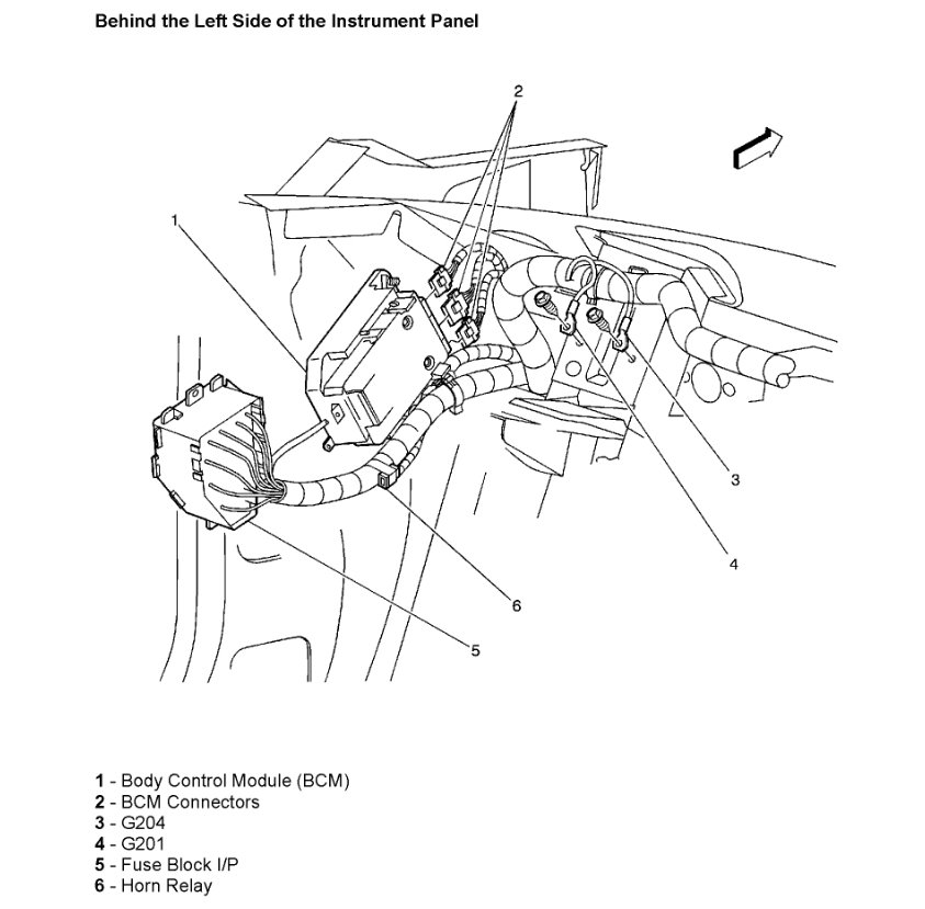

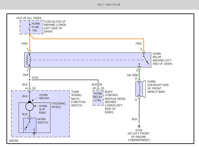

Here is a guide to help you check the relay with the location in the diagrams below.

What's up? My car's horn does not work. All fuses are good except that I do not know where the horn relay is located. Does anyone know where it is located????
Apr 25, 2021 at 4:43 AM (Merged)
  • 55,432 POSTS

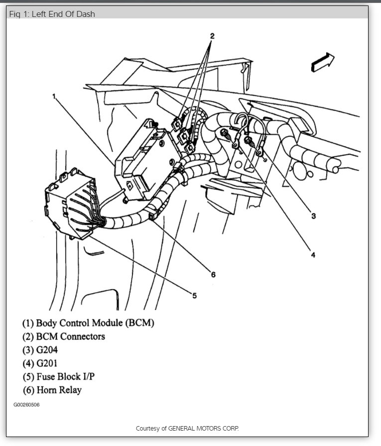

The relay is taped to the main loom into the rear of the fuse box under L/H/dash. Here is a guide and some guides (below) to help you get the problem fixed.

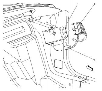

I need to replace horn relay but I cant find it where is it located.
  • 75,992 POSTS
The Horn Relay is located in the Convenience Center. The Convenience Center is located at the right front of the passenger compartment.

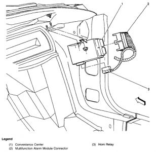

I have a 1998 chevy cavelier, and I can not seem to find the horn relay. Could you tell me where it is located please?
CLY
  • 308 POSTS
The horn relay is built into the Convenience Center. I think you have to replace the hole unit.... Here is a picture of it...(Right Front,Under Dash)
https://images.2carpros.com/forum/automotive_pictures/86485_292111_1.jpg
No#1 is the Convenience Center No#2 is the Multifunction Alarm Module Connector No#3 is the Horn Relay connector
