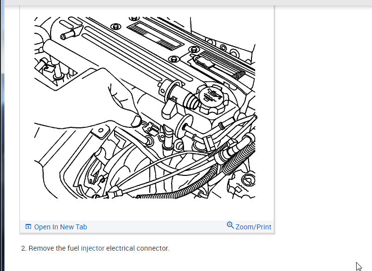

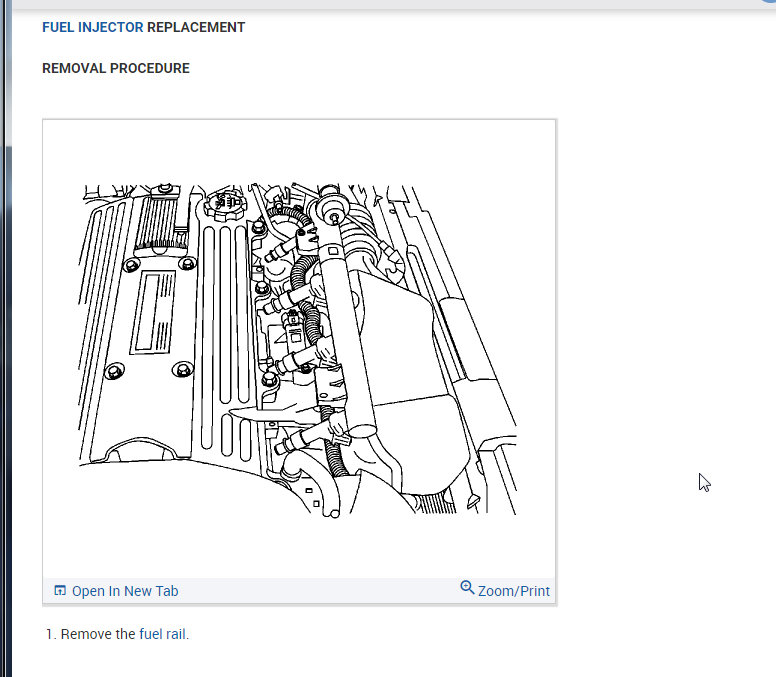

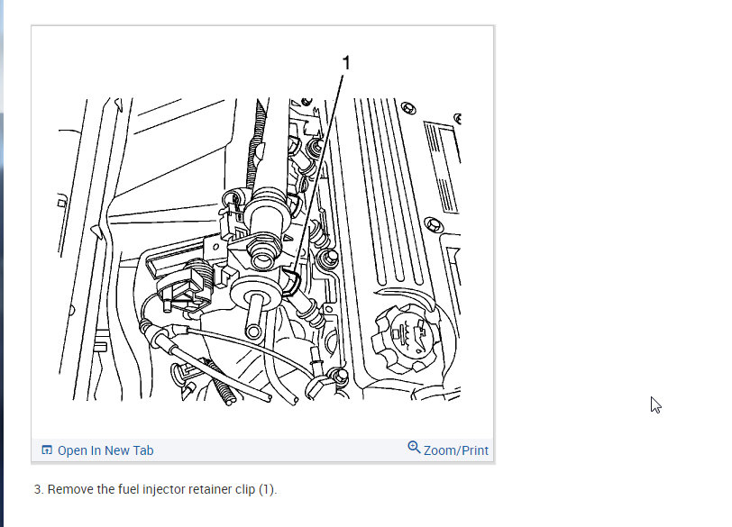

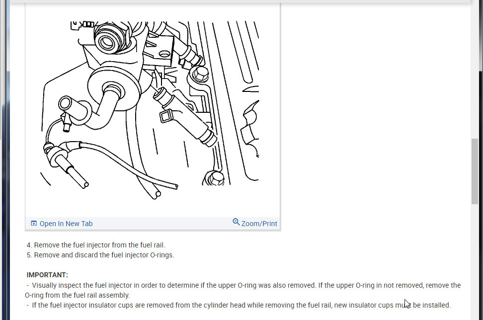

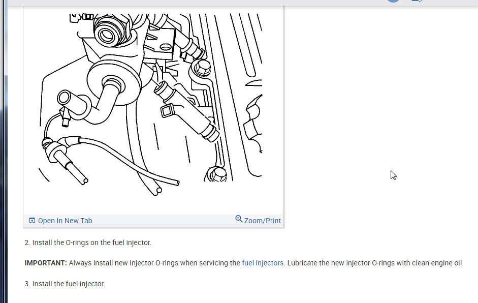

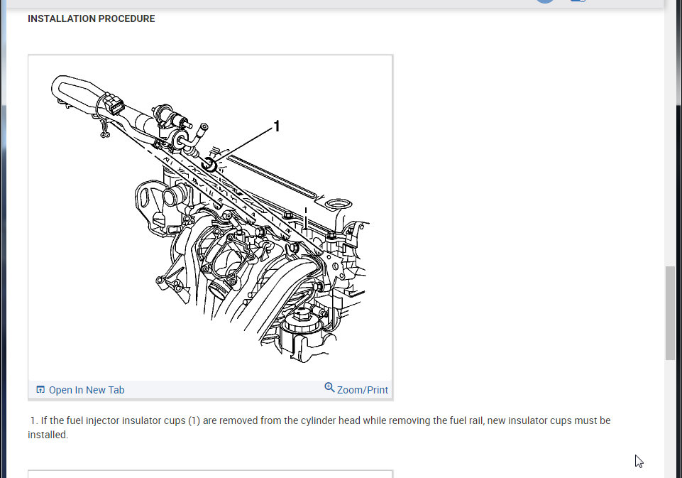

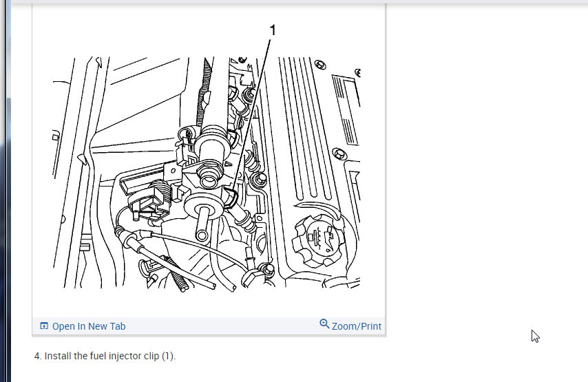

When I start my car it has a strong gas smell, I had the gas filter changed thinking it would stop the smell but it not. I found out 2 of my fuel injectors are leaking can you help me change them out?
Nov 18, 2008 at 1:26 AM
Here is a guide that will help with this:
https://www.2carpros.com/articles/how-to-replace-a-fuel-injector
Plus below you will find the process from the manual that will give the info from the manual that you need.
Please let us know if you have other questions. Thanks
