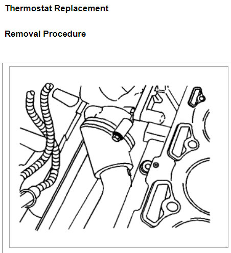

Where can I find the location of the thermostat for this car? It is a 2.2L. Anyone help!! I don't want to take it to the shop!

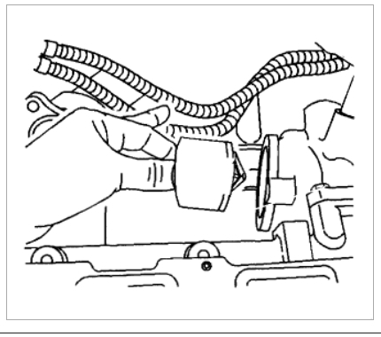

the thermostat for this car is down behind the water pump here is a guide to help you see what you are in for when doing the job.
Here is the location for your car (below)

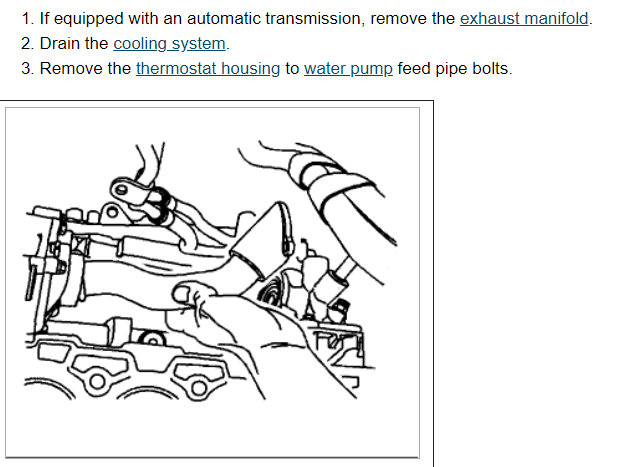

Follow lower radiator hose to water pump and you will find thermostat.
Here are procedures for installation and removal for 2.2L engine:
If your eighth digit in VIN is 4:
REMOVAL:
Drain the cooling system.
Remove the lower radiator hose from thermostat outlet.
Remove the thermostat outlet bolts and outlet
Remove the thermostat.
Clean the mating surfaces of the radiator outlet and the radiator outlet pipe
INSTALLATION:
Install the thermostat.
Install the thermostat outlet and bolts.
Install the coolant outlet attaching bolts and tighten the thermostat outlet bolts to 10 ft. lbs. (14 Nm).
Install the lower radiator hose to thermostat outlet.
Fill the cooling system.
Inspect for leaks.

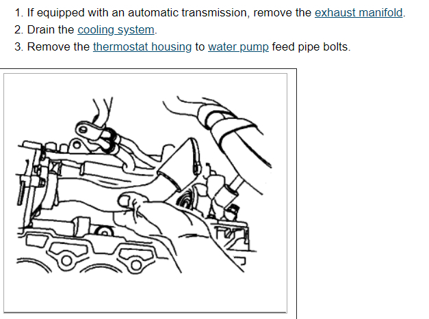

If your eighth digit in VIN is F:
REMOVAL:
If equipped with an automatic transmission, remove the exhaust manifold.
Remove the thermostat housing to water pump feed pipe bolts.
Remove the thermostat housing to water pump feed pipe.
INSTALLATION:
Install the thermostat housing to water pump feed pipe.
Install the thermostat housing to water pump feed pipe bolt and tighten the thermostat housing to water pump feed pipe bolt to 89 lb inches (10 Nm).
If equipped with an automatic transmission, install the exhaust manifold.

In the place you'd least want to see it. It's under the exhaust manifold. Since you've got an automatic transmission to get at it you'll have to remove the exhaust manifold. Not as bad as it sounds still is going to take a couple hours. Good luck.

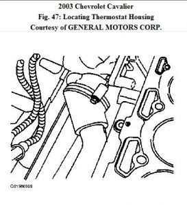

could you please tell me the location of the thermostat?
Mar 1, 2018 at 9:15 AM (Merged)
FISHERMAN
  • 937 POSTS
Hello !! Here you have the pic. of the thermostat location:
https://images.2carpros.com/forum/automotive_pictures/576_cavalier_thermostat_1.jpg
good Luck!
