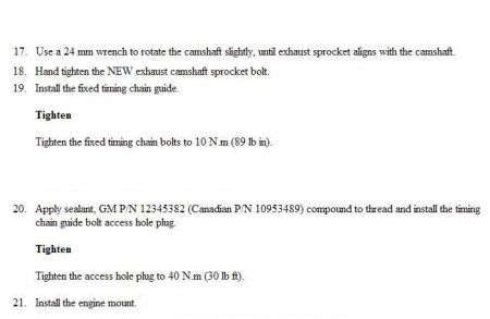

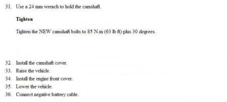

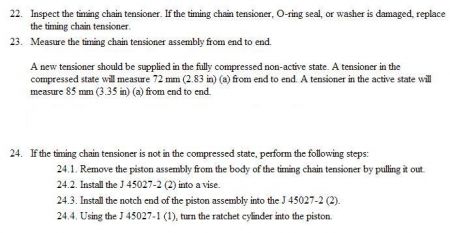

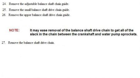

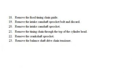

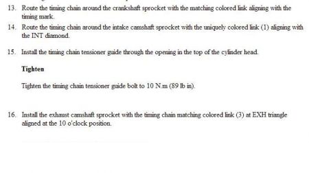

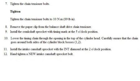

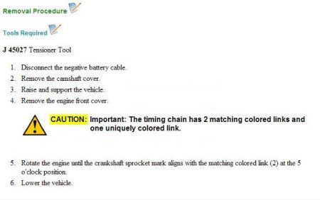

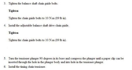

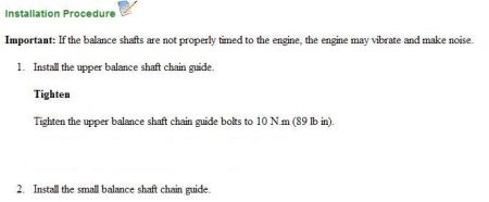

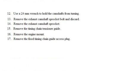

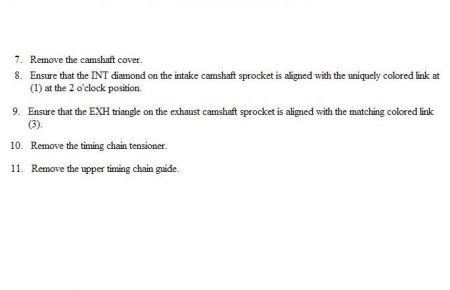

How do I replace the timing chain in my cavalier. what do I do first, next, etc. I need help. I bought the parts plus the tensioner. HELP!!!!
