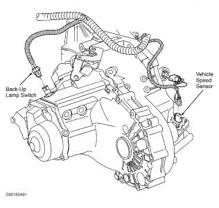

Where is the speed sensor located at on a 2003 cavalier?

The speed sensor located in the transmission, here is a diagram that shows where it is.
