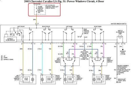

2003 Chevy Cavalier 4 cyl Automatic

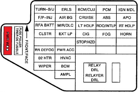

I need to find out where the Relay Assembly/Express Down Module. I cannot find where it is. I have looked in the fuse boxes, the center console and under the dashboard. A speed reply would be wonder we are expecting rain and the window is down. To bring it up I need to replace the module soon (today).

It is not a relay, it is a circuit breaker.
https://images.2carpros.com/forum/automotive_pictures/55316_03cavalierpw_1.jpg
https://images.2carpros.com/forum/automotive_pictures/55316_03cavalierfuse_1.jpg
