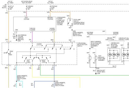

I have no brake lights, turn signals or hazard lights. I have replaced all rear bulbs. After checking and replacing fuses, what is my next step?

Does the 3rd brake light work, and did you check those bulbs as well. Those are on a different circuit and may help narrow it down. The rest go therough the multifunction switch.
https://images.2carpros.com/forum/automotive_pictures/30961_1cav_1.jpg
