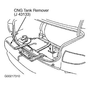

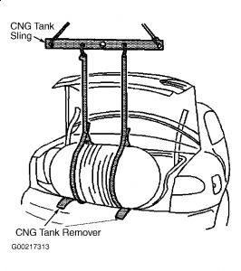

I just replaced the fuel pump now I can not get the fuel
tank back in place. Do I need to take off both brackets?
Oct 8, 2009 at 10:52 AM
BLUELIGHTNIN6
  • 16,542 POSTS
you need special tools for this job.. you will need the CNG Tank Remover tool # J 43133 and the CNG Tank Sling tool
