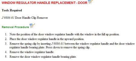

i want to change my speakers on my car but i don't know how to take off the door panal's well mainly the window crank i want to convert to power windows but don't know how can anybody help me

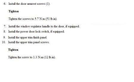

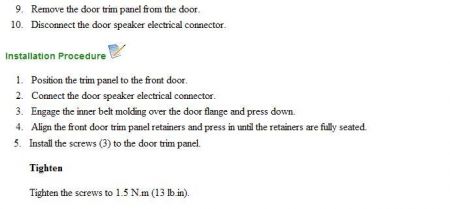

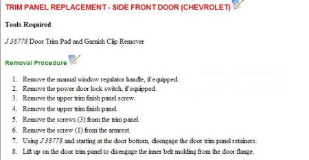

https://images.2carpros.com/forum/automotive_pictures/261618_Noname_1169.jpg
https://images.2carpros.com/forum/automotive_pictures/261618_Noname2_339.jpg
https://images.2carpros.com/forum/automotive_pictures/261618_Noname3_128.jpg
https://images.2carpros.com/forum/automotive_pictures/261618_Noname4_64.jpg
https://images.2carpros.com/forum/automotive_pictures/261618_Noname5_30.jpg
