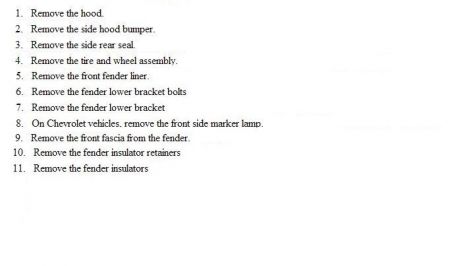

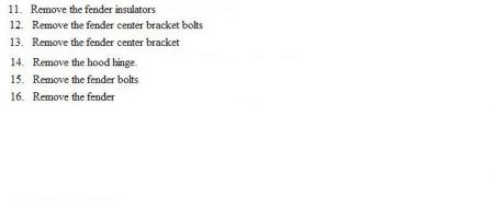

I am wondering how I can install a front fender on my vehicle.
Oct 16, 2009 at 2:37 PM
BLUELIGHTNIN6
  • 16,542 POSTS
https://images.2carpros.com/forum/automotive_pictures/261618_Noname_1086.jpg
https://images.2carpros.com/forum/automotive_pictures/261618_Noname2_312.jpg
