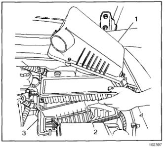

How do you replace the air filter?
Feb 1, 2010 at 11:50 AM
  • 75,992 POSTS
2003 Chevrolet Cavalier L4-2.2L VIN F AIR CLEANER ELEMENT REPLACEMENT REMOVAL PROCEDURE
https://images.2carpros.com/forum/automotive_pictures/12900_af1_1.jpg
1.Remove the upper air cleaner screws. 2.Remove the upper air cleaner cover (1). 3.Remove the air cleaner filter (2) from lower air cleaner housing (3). 4.Inspect the air cleaner filter for dust, dirt and water. 5.Replace if required. INSTALLATION PROCEDURE
https://images.2carpros.com/forum/automotive_pictures/12900_af2_1.jpg
1.Install the air cleaner filter (2) into the lower air cleaner housing (3). 2.Install the upper air cleaner cover (1) to lower air cleaner housing. 3.Install the upper air cleaner screws. NOTE: Refer to Fastener Notice in Service Precautions. Tighten Tighten the upper air cleaner cover screws to 3 N.m (27 lb in).
