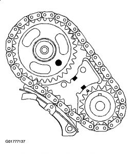

2002 Chevy Cavalier Timing Gears & or Chain
2002 CHEVROLET CAVALIER
BOBBYBROWN
Engine Mechanical problem
2002 Chevy Cavalier 4 cyl Two Wheel Drive Automatic 100k miles
How do I replace?
Mar 25, 2010 at 7:04 PM
BMRFIXIT
  • CAR REPAIR CONTRIBUTOR
  • 19,053 POSTS
Timing Chain & Sprockets Replacement Tools Required J 22888-20A Universal Two Jaw Puller J 5590 Pinion Bearing Race Installer-Rear Removal Procedure Remove the engine front cover. Align the crankshaft sprocket and camshaft sprocket timing marks with the alignment tabs on the timing chain tensioner. Important: Before removing the timing chain, measure the distance between the hole in the bracket and the unworn surface of the timing chain tensioner shoe. If the distance between the hole and the unworn surface of the timing chain tensioner shoe is more that 8 mm (0.314), replace the tensioner, timing chain, and both sprockets. Remove the timing chain tensioner bolts. Remove the camshaft sprocket bolt. Remove the camshaft sprocket and timing chain. Remove the Torx ® bolt and the tensioner assembly. Remove the crankshaft sprocket using J 22888-20A .
https://images.2carpros.com/forum/automotive_pictures/99387_Graphic1_697.jpg
