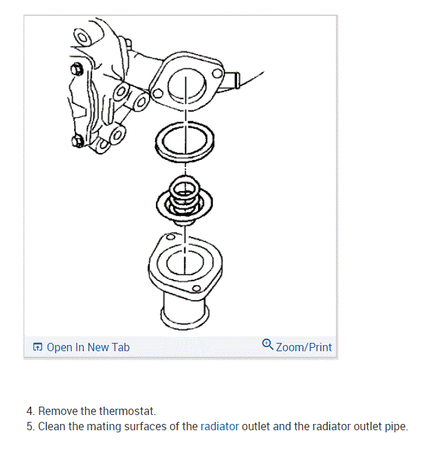

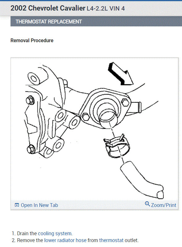

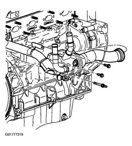

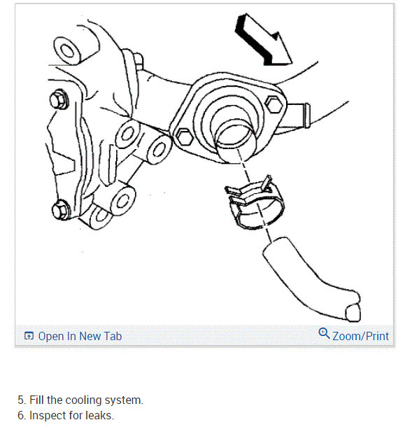

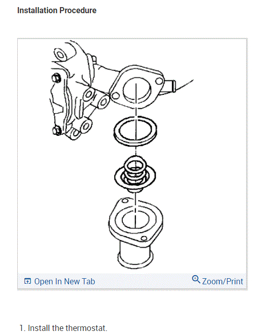

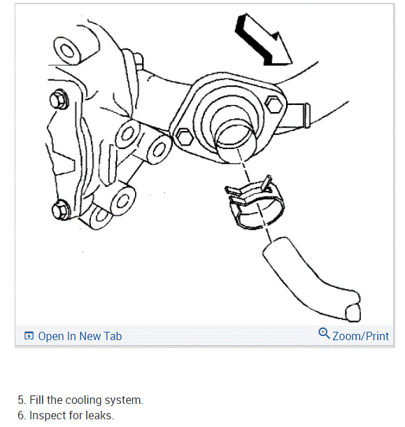

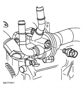

Could you please tell me the location of the thermoset so that I can change it myself.

BMRFIXIT
  • 19,053 POSTS

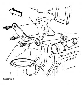

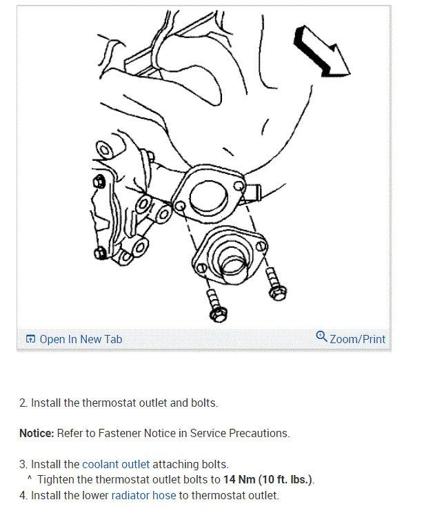

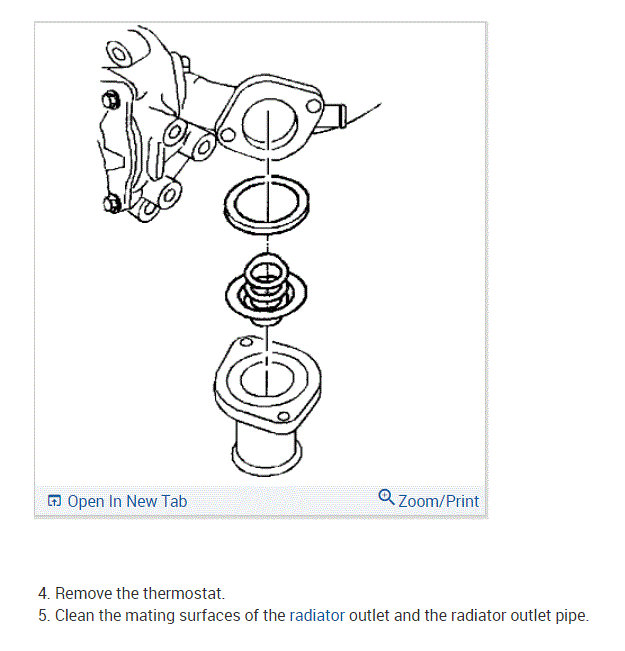

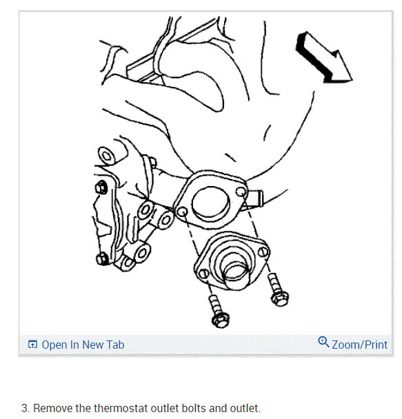

rear of water pump inlet pipe
https://images.2carpros.com/forum/automotive_pictures/99387_Graphic3_24.jpg
https://images.2carpros.com/forum/automotive_pictures/99387_Graphic2_52.jpg
https://images.2carpros.com/forum/automotive_pictures/99387_Graphic1_102.jpg

Replacing the thermostat on this vehicle really isn't too hard. You will need a few things when doing it. Make sure to have a container you can fit under the radiator to collect coolant. Also, have a few shop towels and general tooling prepared in advance.
To get you started, here is a link that shows in general how to replace one. You can use this as a guide.
If you look at the pics below, they provide the directions specific to your vehicle.
