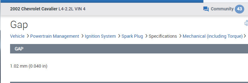

I just need to know what the spark plug gap should be on my car it has the 2.2 liter engine. Can you show me how to replace the spark plugs?
Mar 14, 2010 at 9:31 AM
  • 75,992 POSTS
The gap should be .040. Check out the diagrams (below). Please let us know what you find.

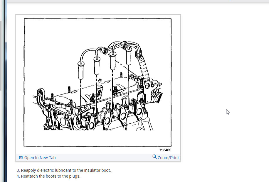

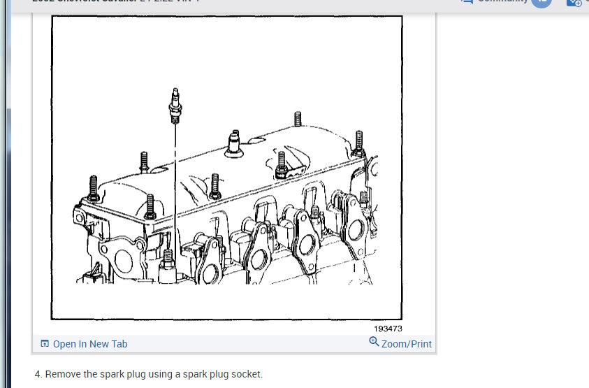

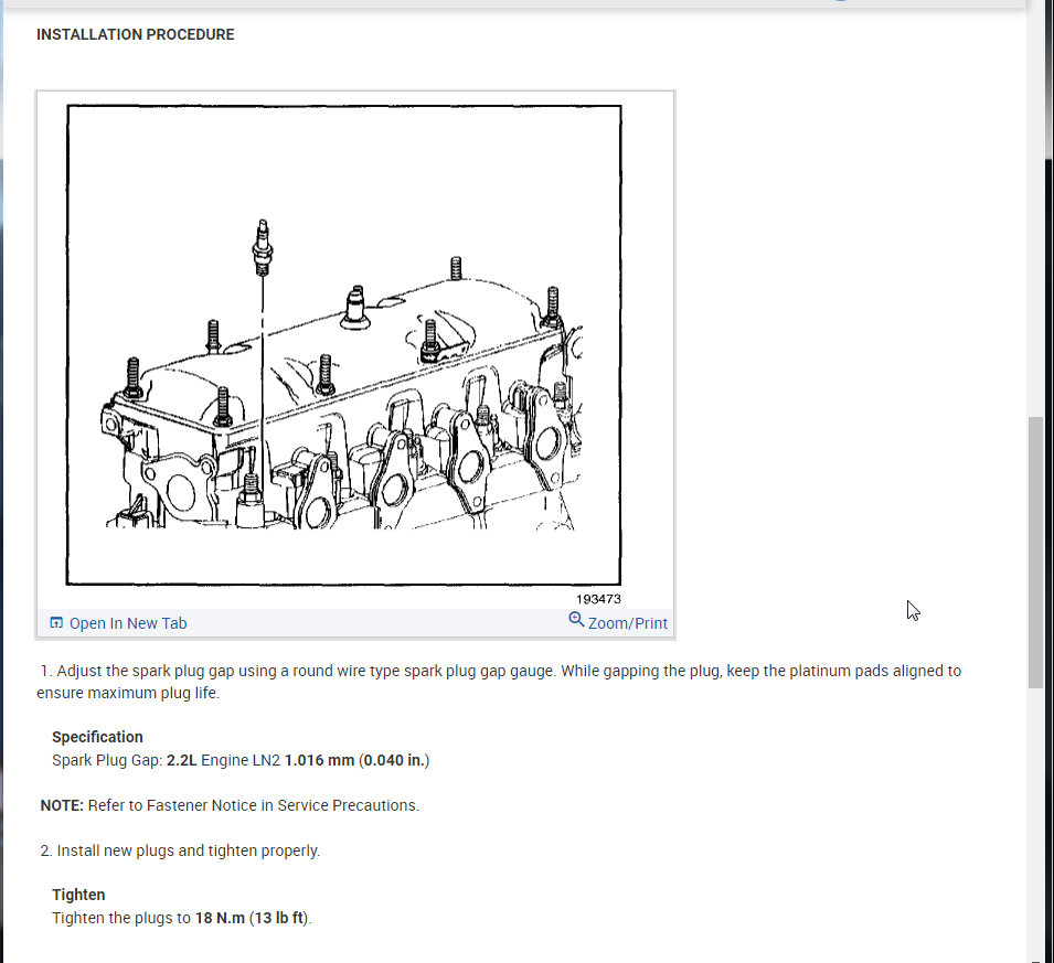

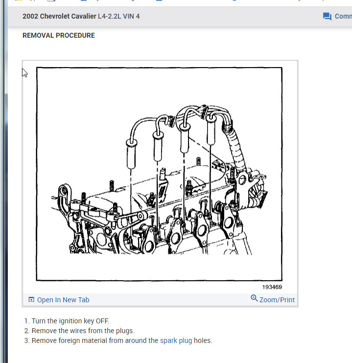

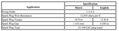

I am attaching the entire procedure on how to replace the plugs for this engine which includes the gap spec that is listed above as well as the torque specs.
