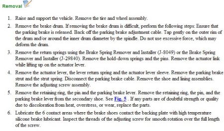

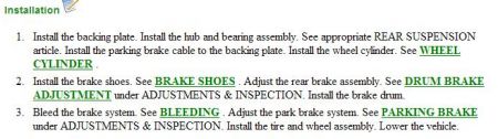

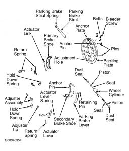

how do i replace the rear drum brakes on my 2002 cavalier
Nov 28, 2008 at 8:06 PM
MHPAUTOS
  • 31,937 POSTS
brake removal as per text, mark (mhpautos)
