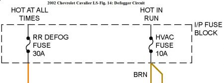

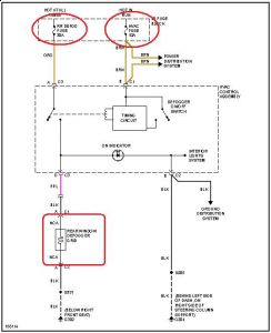

the rear window defogger quit working. the fuse is good and the light comes on the switch but there is no power to the window. is there another fuse or relay or could it be a faulty switch?

Make sure both fuses are good. If they are, and since the light is on, you may need to check voltage at the defogging grid.

where would the other fuse be located?I have checked the one in the fuse panel and it is ok.
