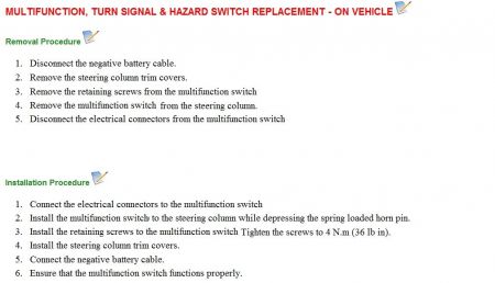

Interested in finding out procedure for removing steering wheel with air bag ,To replace turn signal/headlight switch module also the cruise cntrl. is included on lever?

https://images.2carpros.com/forum/automotive_pictures/261618_Noname_2864.jpg
