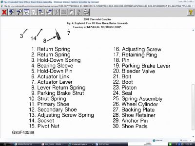

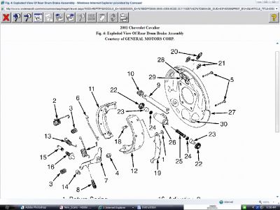

the rear brakes on my car keeps locking i have cleaned all the dust out the pads are in good shape the self adjusters are not tight the rear wheel turns freely and the e brake is not tight open for suggestions
Mar 16, 2008 at 8:44 AM
MERLIN2021
  • 17,250 POSTS
Make sure the primary and secondary shoes are not reversed! You did turn or replace the drums? And there is no contaminats on the linings? And don't forget, a small bit of white lith grease on the pads...thats the area the shoe rests on! New hardware?
