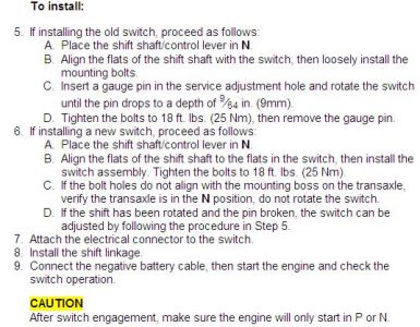

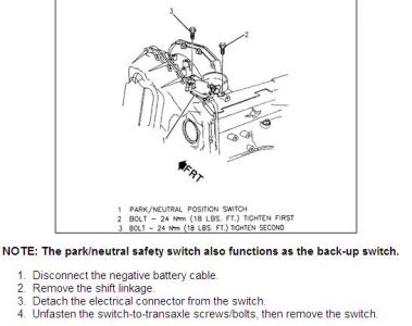

How do you replace it
Saturday, January 10th, 2009 AT 2:36 PM
JDL
MECHANIC
16,098 POSTS
On a 4t40e, the info shows this.
