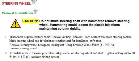

How do you change the multi function switch on a 2001 Chevy Cavilier? All other issues are ruled out. and now i will attempt to change this myself.

https://images.2carpros.com/forum/automotive_pictures/261618_Noname_1468.jpg
https://images.2carpros.com/forum/automotive_pictures/261618_2_78.jpg
