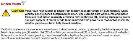

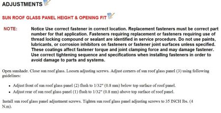

how would i adjust the tracking on the moon roof so both sides line up correctly when closed?
