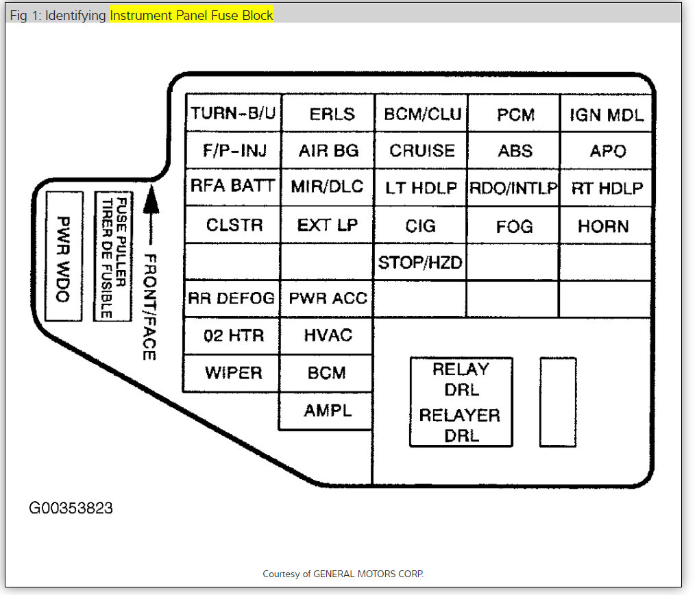

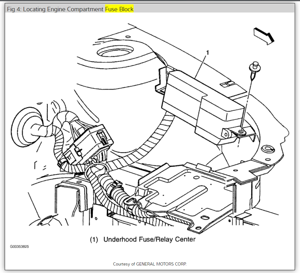

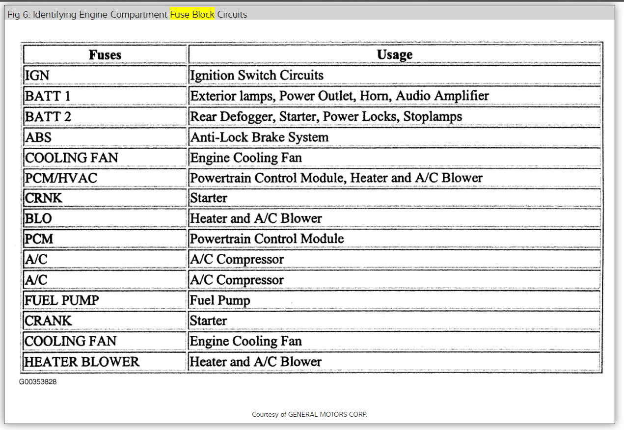

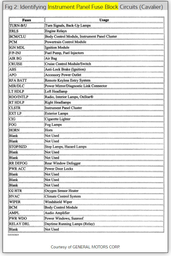

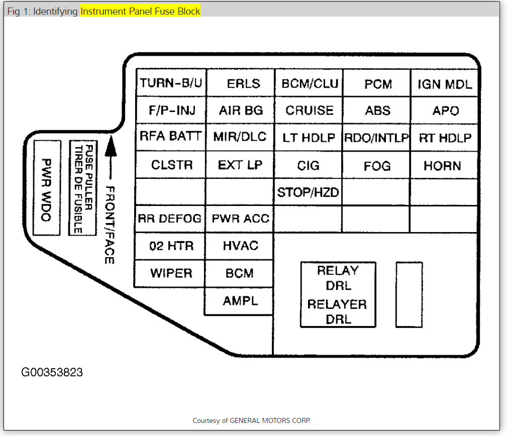

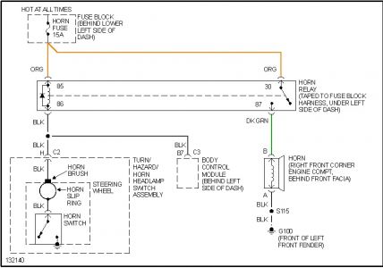

i hit my horn on the steering wheel a couple of times. now my horn doesn't work. i've checked the fuse nothing was wrong with the fuse. i know i did something to it by hitting it on the steering wheel..help how can i get my horn back to working.
Oct 15, 2010 at 4:06 AM
JDL
  • 16,098 POSTS
Any fuse you checked, did you use a voltage tester on the fuse circuit? Even if the fuse is good, if no voltage on the circuit, the circuit is dead. Usually the problem is in the steering column/steering wheel. You need to disarm the air-bag, where applicable, before trying to work on it.
https://images.2carpros.com/forum/automotive_pictures/170934_cavalier_horn_diagram_1.jpg
