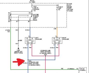

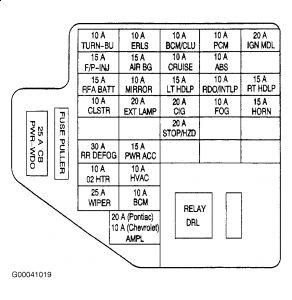

daytime running lights and low beams will not turn on.Have changed the switch on the steering column, the headlight bulbs,and the relay switch in the fuse box...still will not turn on, only have highbeams. HELP!! I'm out of answers.

Hello .. thanks for the donation .. much appreciated Check the fog lamp fuse in the instrument panel fuse box .. this controls DRL relay/low beams and fog light's
https://images.2carpros.com/forum/automotive_pictures/266999_cav_1.jpg
hope this helps
https://images.2carpros.com/forum/automotive_pictures/266999_AAA2_1008.png

DAVE H
  • 13,384 POSTS
Hey. Check the wiring/junction/connector behind the driver side headlight ... check for damage/wear/good connection repair any faults and recheck DRL function NOTE:- this wiring harness connector has other wires, not just the blue shown on diagram !!
https://images.2carpros.com/forum/automotive_pictures/266999_cav_2.jpg
