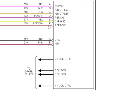

car has no spark. What could the problem be? replaced the plugs,wires and coil packs. has a new baterry,alternator,,and starter,and a crank sensor. what else could the problem be?

Also, check B+ and ground at the ignition module. The pink wire is voltage, goes hot when you turn on the key. Black wire is ground.
https://images.2carpros.com/forum/automotive_pictures/170934_cavalier_ignition_module_1.jpg

where are they located

The coil pack sits on top of ignition module. Top rear of engine. I looked at 2.2L engine, vin4.

Is it the ignition module that's bad?

It's possible,but, without a little testing, can't be sure. I hate to see you throw parts at it.

what testing would have to be done. the car don't start to take it to a garage and have no money for a tow

Use a testlite between pink and black wire, key on, see if lite comes on. Use a noid lite check for injector pulse, engine cranking.
