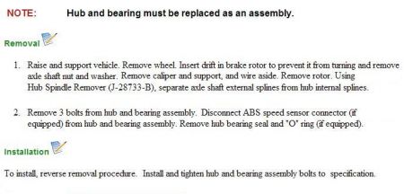

i have the tire, rotor, axle nut, and all three hub/bearing bolts off the car but still cannot get the hub and bearing assembly off the car on either steering knuckle... am i missing something or is this just rust? (the three hub bolts were very hard to get off)
