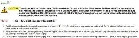

This car does not have a trans. fluid dipstick. How do I check the transmission fluid level?

https://images.2carpros.com/forum/automotive_pictures/261618_Noname_1843.jpg
