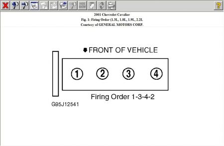

Can you please tell me what the firing oder is for a 2001 chevy cavalier that has a 2.2 liter engine? I'm changing out a bad injector.

Here it is
https://images.2carpros.com/forum/automotive_pictures/12900_fo_13.jpg
