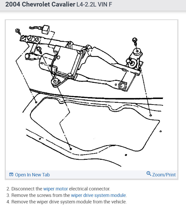

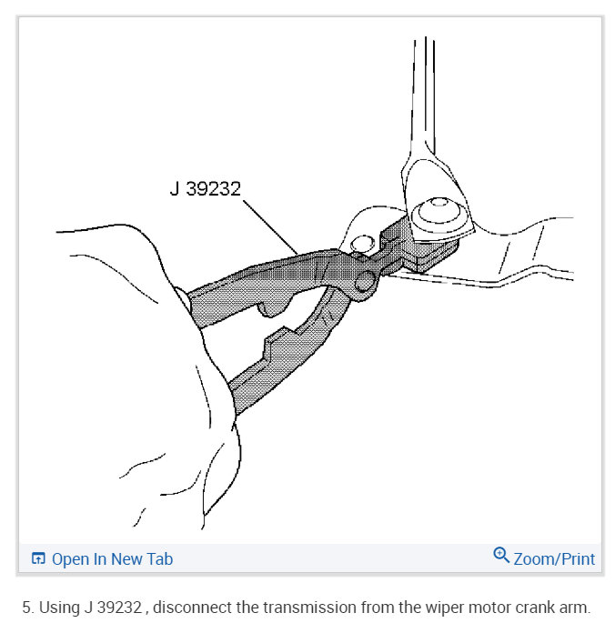

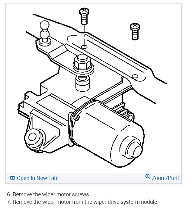

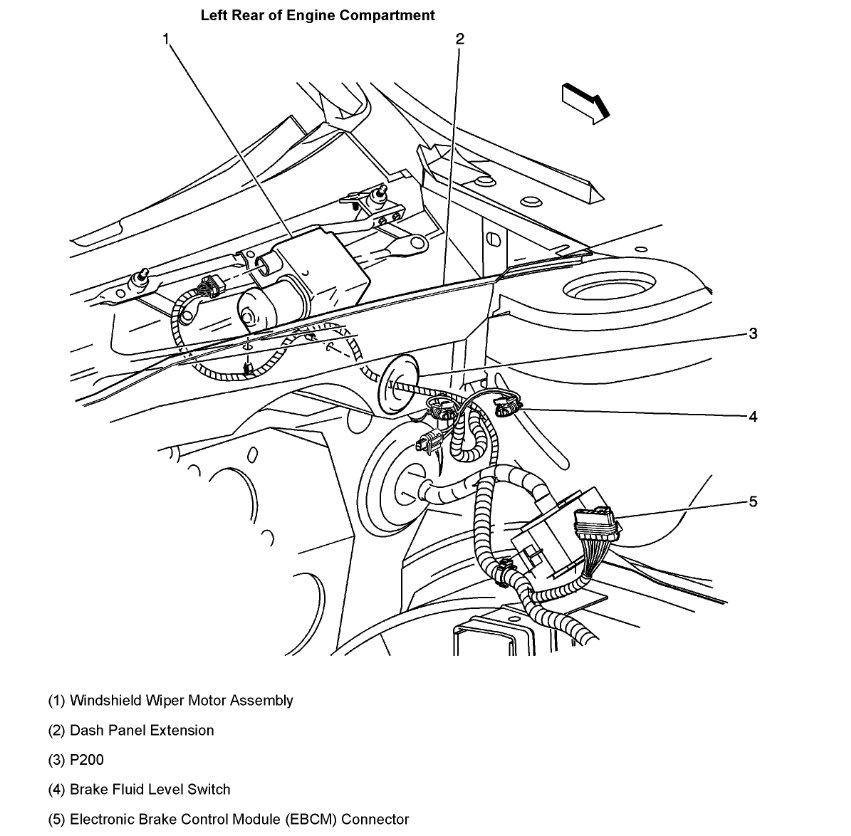

i was driving with my windshield wipers on and heard a pop and the wiper on the driver side stopped working. I can move the wiper freely by itself. If I turn the wipers on the passenger side still works, but the driver side does not work. Can you tell me what this might be?
