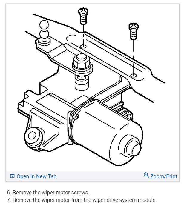

i was driving with my windshield wipers on and heard a pop and the wiper on the driver side stopped working. I can move the wiper freely by itself. If I turn the wipers on the passenger side still works, but the driver side does not work. Can you tell me what this might be?
Jan 29, 2010 at 8:59 AM
MMPRINCE4000
  • 8,548 POSTS

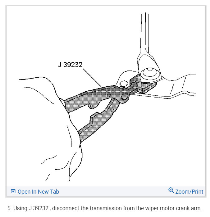

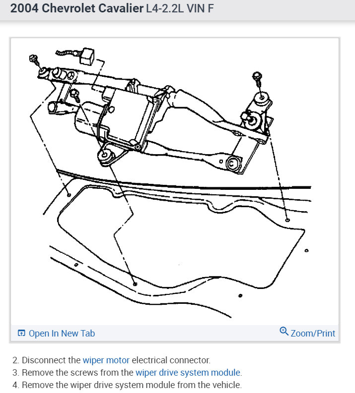

Remove protective cap on base of wiper arm and see if the nut that holds it to wiper trans is loose. If so tighten nut, if the nut is tight the control rod that works the drivers side came off here is a diagrams so you can see what I am talking about. Check out the diagrams (Below). Please let us know what you find. We are interested to see what it is.

the above person has a legitimate answer, but his answer is no where near what the root of my problem was. the problem I came across was not the nut but is the actual bushing which snaps onto the ball joint on the wiper motor arm. the arm is held in place by some cheaply made plastic. i have a 1985 VW and the wipers still work (go figure), the overall design of the wiper system is pretty bad by Chevrolet standards. it is simply bad engineering on that specific part.

The above person is making a conclusion, without seeing the problem. While he has posted about this problem (his own experience), that does not mean every problem falls within his experience.
If there is a TSB concerning this problem please post TSB number.
I would remove the wiper arms, cowl and inspect bushings and linkage assy, could be a bushing, could also be a loose nut, especially on an 2004.
If bushing, then get a replacement from Chevrolet, but check the nut first. Start simple and work your way up.

i did not make a conclusion without seeing what the problem was. i fixed my problem which happened to be a faulty linkage bushing. that is why i took a picture and went into detail with the problem i had.

I have the same issue myself. I have visually inspected and found the same bushing to be split in half causing the linkage arm to fall from the ball joint on the bottom of the wiper motor. I have tried Dorman replacement bushings with no luck. Chevrolet wants to sell the entire linkage kit for $197.00. all this to replace a bushing that should sell for about $5.00. Do you have a part number and source to order this bushing from?

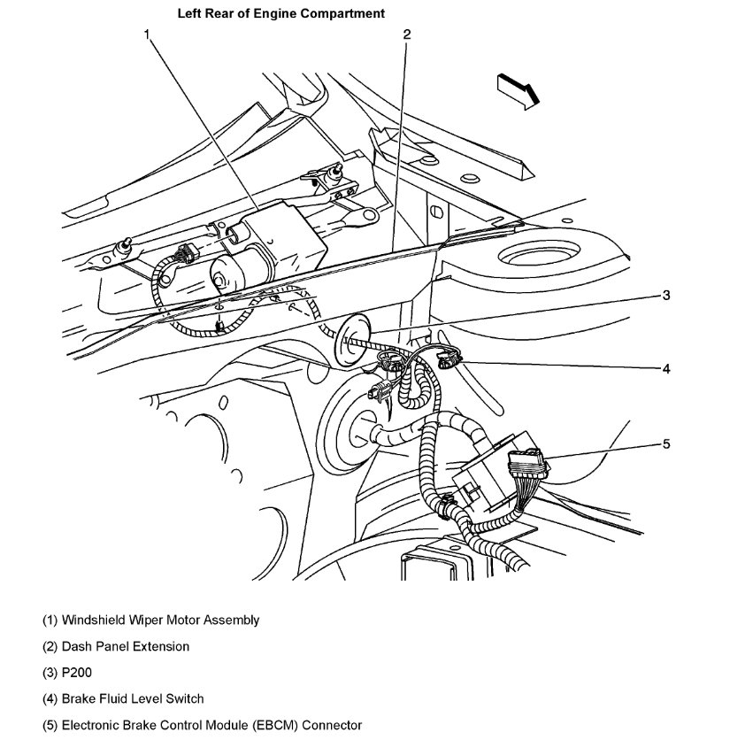

IMPALASS
  • 3,112 POSTS
To better support you is your model just the Cavalier or the LS or LS Sport. Also, what is you engine size in liter? Last, while I am starting to look up the information is your lights and wipers on the same switch?
Dec 27, 2016 at 6:12 PM (Merged)
GGROCCO43
Regular model, four cylinder, changed fuses, dealer took out steering column could not find anything. lights and wipers are on different switches.
IMPALASS
  • 3,112 POSTS
Thanks for the information.
First check all the wiring by and under the battery tray. You are looking for corrosion and bad connections.these must be clean and good contact. There is a splice number SP102 that is under the battery tray. Both the wiper and headlights go to this. Remove the battery and tray and as I said look really good peel some of the insulation back it you have to. To clean all battery corrosion use Arm&Hammer baking soda mixed with water you do not want paste or as thick as pancake mix but nice full of the soda and do not get it on the battery.

MMPRINCE4000
  • 8,548 POSTS
You will have to remove the plastic cowl to gain access.
Make sure the wiper arm bolts are tight, if so then remove cowl and inspect transmission assembly for broken parts.
