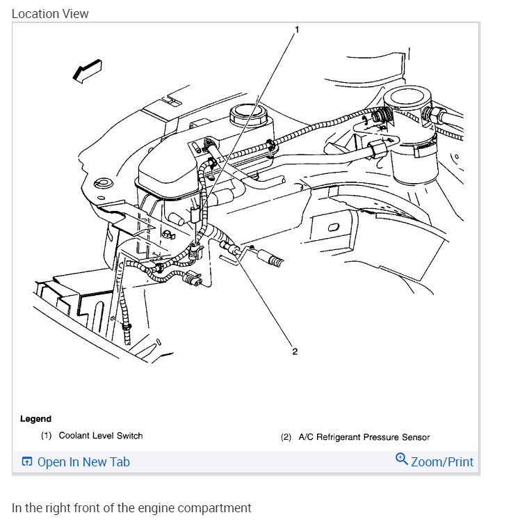

The computer is not outputting the the cooling fan relay. Where is the input sensor (I assume it is a thermocoupler)? I need to check if this bad. Relays are good and I can jump the relay points to make the fan run. Would prefer not to wire in a toggle switch for the fan.
Nov 3, 2010 at 7:07 AM
WRENCHTECH
  • 20,758 POSTS

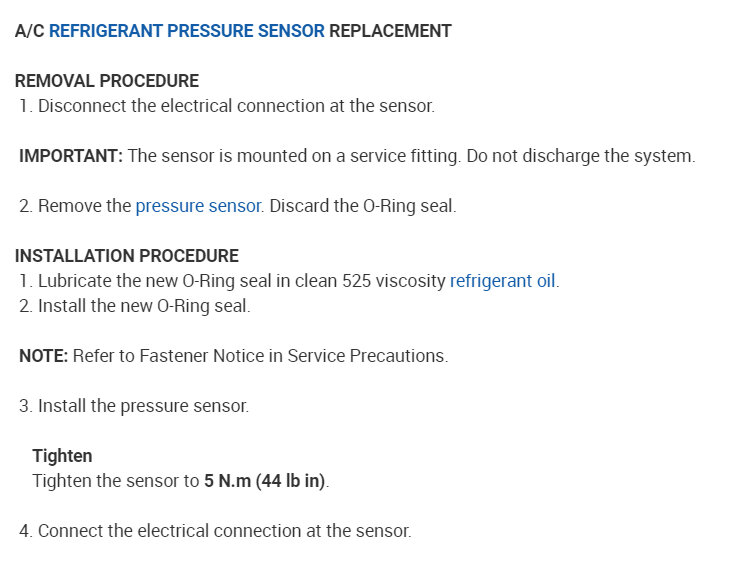

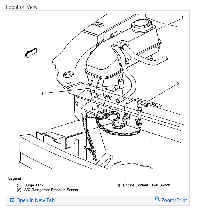

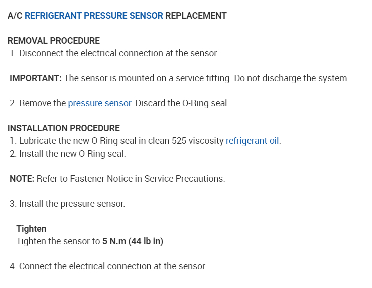

The ac pressure sensor is near the coolant reservoir on some models but they change it on others. Here is a diagrams to show you the location. Check out the diagrams (Below) Please let us know if you need anything else to get the problem fixed.
