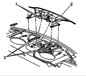

How do i change my center brake light ? and how do i know which bulb size to use?

Bulb type you need to check the auto parts store
https://images.2carpros.com/forum/automotive_pictures/12900_braKE_1.gif
REMOVAL PROCEDURE Disconnect the electrical connector from inside the rear compartment. Disconnect the lamp sockets (1) from the lamp assembly. Pull and twist the bulbs to remove from the sockets. Remove the rear window panel trim. Pull the lamp assembly (2) forward to disengage it from the retaining slots (3). INSTALLATION PROCEDURE Install the lamp assembly (2) by aligning the tabs (3) and pushing rearward. Install the rear window panel trim. Install the lamp sockets (1). Connect the electrical connector.
