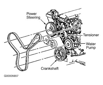

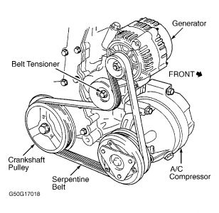

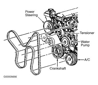

what is the serpentine pattern for a 2000 Chevy cavalier?

With A/C
Without A/C
With 2.4L engine
