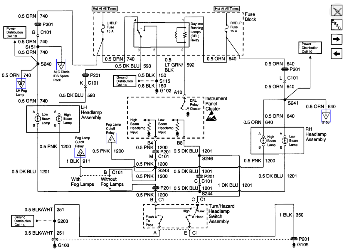

when driving at night my headlights fade from bright to dim and back and forth. Same thing when high beams are on. Any suggestions?

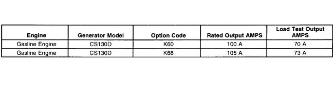

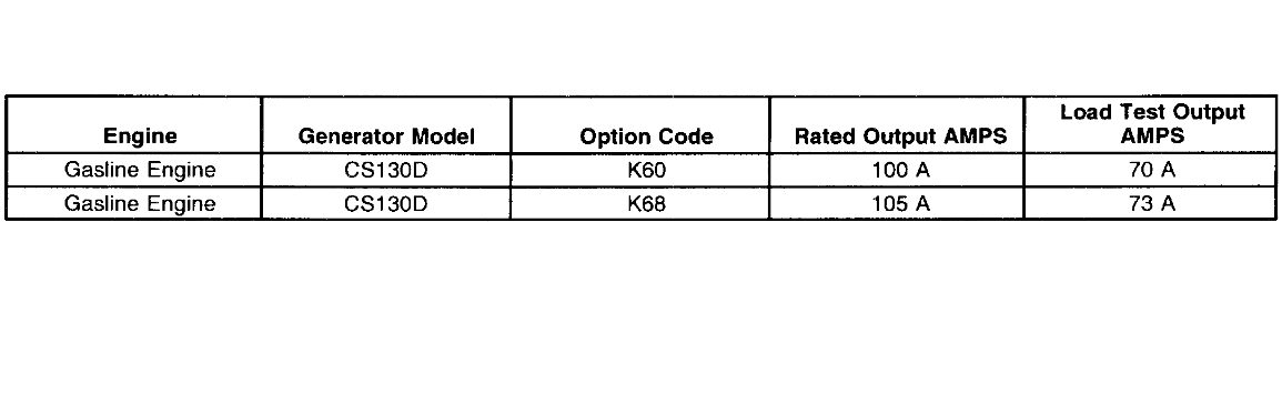

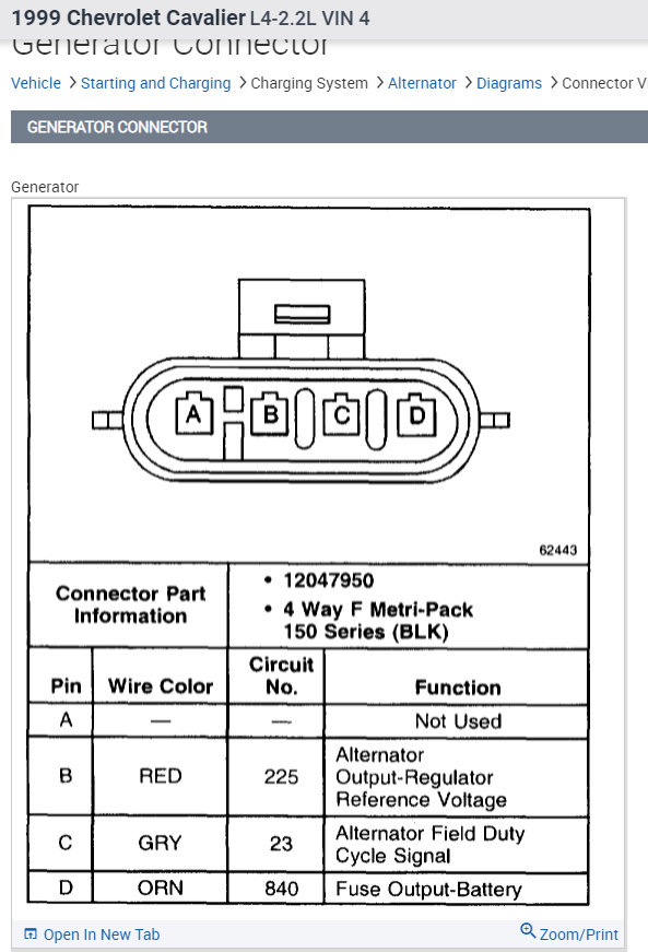

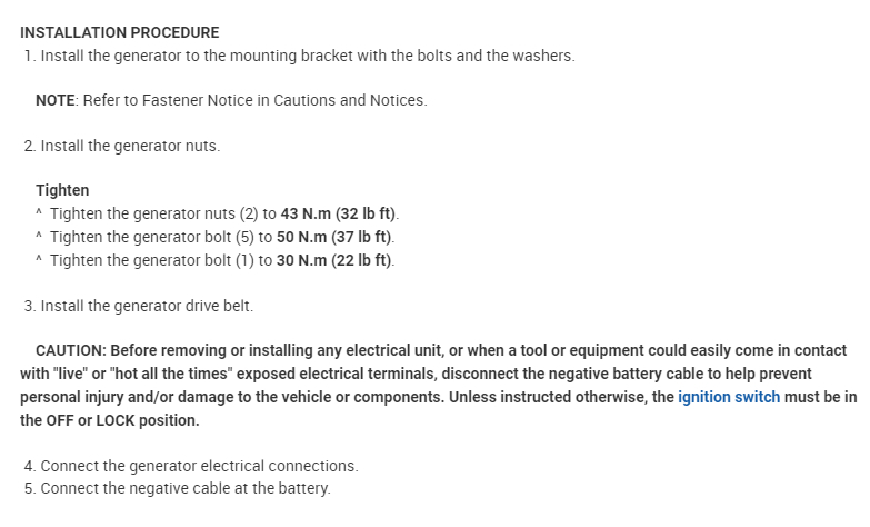

If you are noticing the headlight gets brighter as the engine revs up then it could be due to a bad alternator.
So checking the alternator should be a good first step.
Here is a guide on how to test the alternator:
