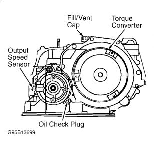

Transmission problem
1999 Chevy Cavalier 4 cyl Front Wheel Drive Automatic
i dont have a dipstick and it leaked out fluid. it calls for 4 quarts does it take more for the torque converter?

Transmission does not have a dipstick. Fill to bottom of fill plug Fluid level must be checked at temperature of 104 °F (40 °C). To obtain proper temperature, perform the following: Idle vehicle for 3-5 minutes. Shift into each gear position, holding in each position for 3 seconds. Place gear selector in Park. Raise and support vehicle. Place oil drain pan below oil check plug. Oil check plug is located in center of transaxle above pan rail, on torque converter side. Remove oil check plug it take 4 to 8 qts of fluid
