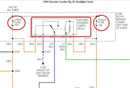

My daytime running lights are not coming on while the car is running, and the high beam indicator is always on, on the dash while the car is running. I checked all fuses in the fuse panel and none are blown

Check the fuses again, especially the circled ones. But I am almost positive that the problem lies with the DRL relay.
