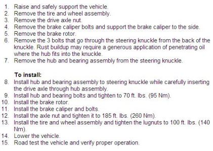

HOW DO I CHANGE MY FRONT WHEELE BEARING ON DRIVER SIDE

Hello, if possible, I loosen the hub nut first, with the tire on the ground. Don't let the caliper hang by the hose, use a piece of wire. I don't recall the size of the hub nut, on some models it is metric. A good set of tools helps alot. Make sure to safely support the vehicle.
