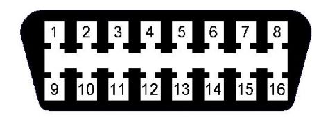

2 scanners will not recognize the scanner connection to read code for check engine light, runs ruff cold. Check engine light went out when I disconnected bat. To replace belt tentioner. Came back on after 10 miles. Need to read codes to repair cold performance problem and hesitation off the line. It's a 2.4 Litre w/5 speed

Hi, pin 16 at datalink connector, is it hot? Gets voltage from cigar fuse.
https://www.2carpros.com/forum/automotive_pictures/170934_obd11_9.jpg
