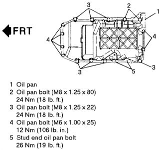

what is the sequence and torque specs for a 1998 cavalier oil pan gasket replacement

For 2.2L engine: Tighten the oil pan retaining bolts to 89 inch lbs. (10 Nm). For 2.3L and 2.4L engines, refer to diagram below.
