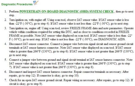

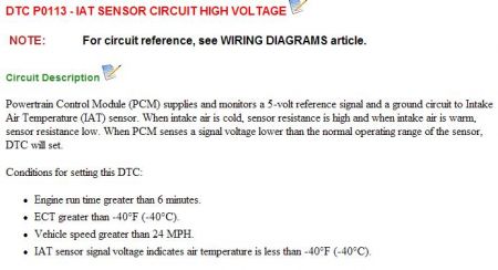

I had ran a OBDII scanner on it and it's giving a code :
Intake Air Temperature Sensor 1 Circuit High Input
can anyone help resolve this problem please.
Thank you for your time.

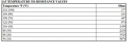

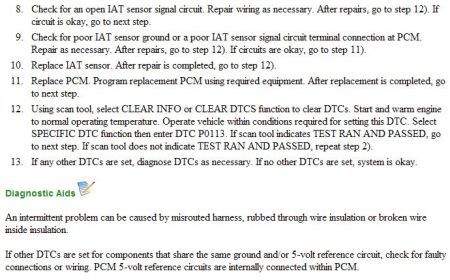

Hello Thanks for the donation. Below is some information about your trouble code along with tests to perform to resolve the issue.
https://images.2carpros.com/forum/automotive_pictures/261618_Noname_137.jpg
https://images.2carpros.com/forum/automotive_pictures/261618_Noname2_44.jpg
https://images.2carpros.com/forum/automotive_pictures/261618_Noname3_20.jpg
https://images.2carpros.com/forum/automotive_pictures/261618_Noname4_11.jpg
https://images.2carpros.com/forum/automotive_pictures/261618_Noname5_5.jpg
