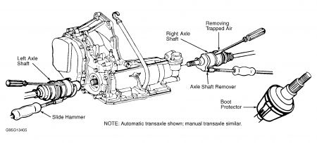

See diagram shows both axles and seals is this what your doing

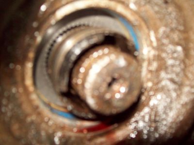

This part around the shaft is what i am trying to remove

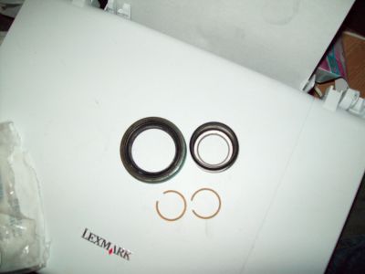

This is the new one from new seal kit but this is what i am trying to remove

That is the output shaft the clip is what holds axle on. The oil seal goes around and seals on axle trace there is no need to replace clip when replacing seal. What is on table don't know. Was problem oil leak or CV joint problem?

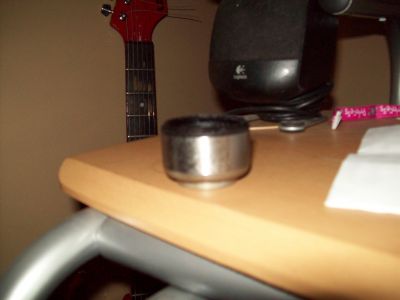

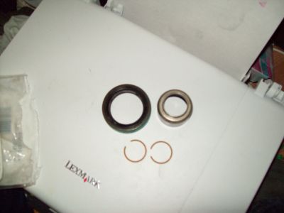

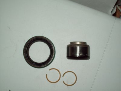

This is what i need to replace if you know what this is can you please tell me

Oil seal is item top left other stuff has nothing to do with axle oil seal. Where did you get? Part number? Name of kit?

Got parts from gm dealership part number 24203910
name seal kit
Monday, November 1st, 2010 AT 2:24 PM
DOCFIXIT
  • 18,828 POSTS
GM part number for axle seal 24233355. Again what was problem oil leak? CV failure? What?

That cupped seal is pressed on just ran into that problem taking it to mechanic
