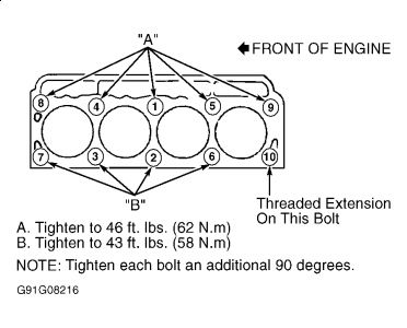

where are the headbolts on the left side of the engine on a 1998 cavalier 2.2 liter

https://images.2carpros.com/forum/automotive_pictures/261618_Graphic_164.jpg
