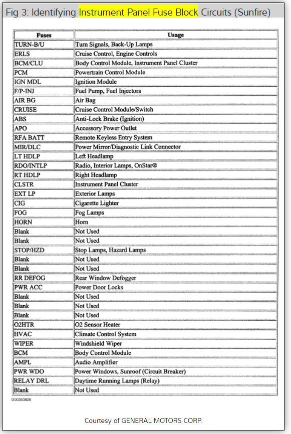

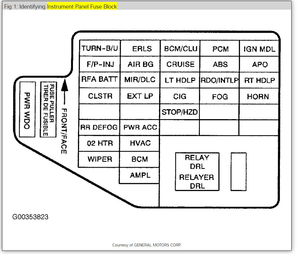

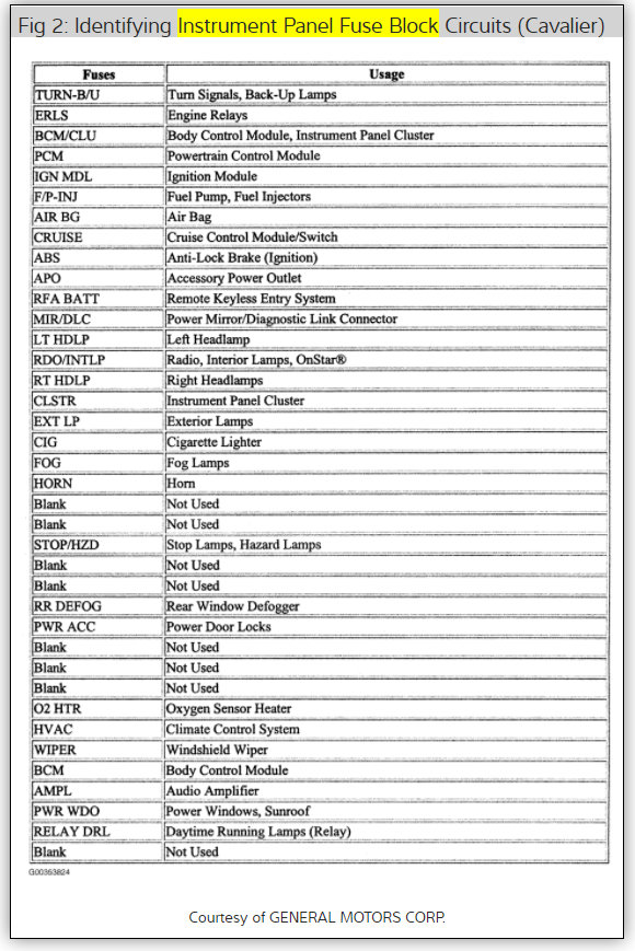

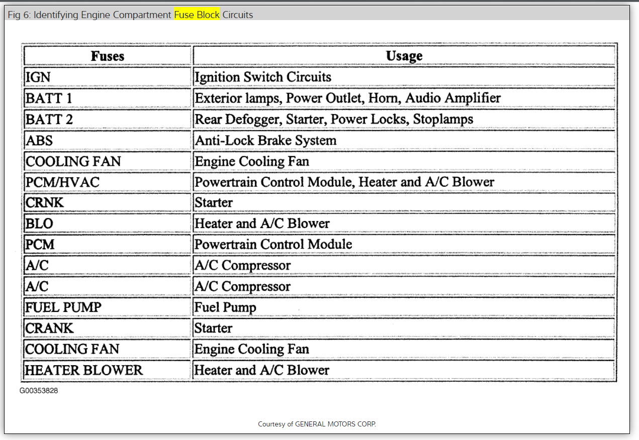

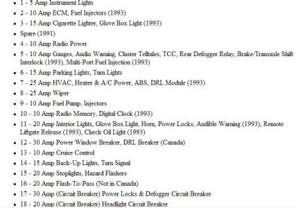

Im looking for a diagram of the fuse box, the cover is gone and i am unable to determine what is what, can you give me a hand at this?
Sep 30, 2009 at 12:43 AM
BLUELIGHTNIN6
  • 16,542 POSTS
Here is a guide to help check the fuse with the fuse diagrams below.
Sep 30, 2009 at 3:42 PM

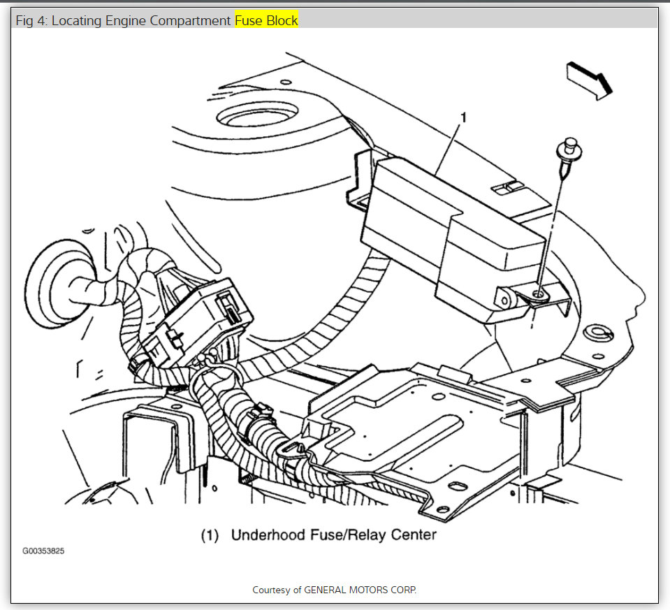

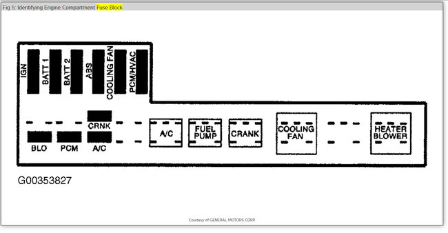

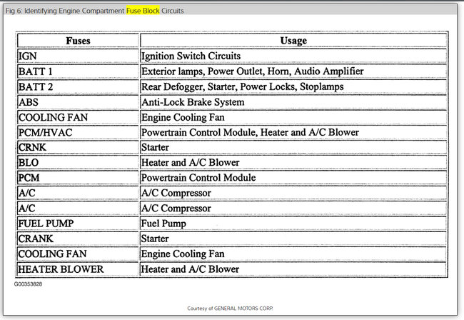

I don't have an owners manual, was wondering if you could help with a fuse panel diagram?
Also I'm worried that the fuel pump isn't working (I can't hear anymore) Any way around that situation without taking the fuel tank out,,,,not looking forward to that!!!!
Any help is appreciated.
Jul 31, 2019 at 4:48 AM (Merged)
BLUELIGHTNIN6
  • 16,542 POSTS
Inspect and test the fuel pump relay which is located in the engine compartment , behind the right strut tower. If it is OK, try banging on the side of the fuel tank to get the pump to kick in. If this works, the pump will need replacing.
