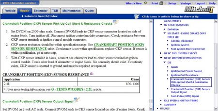

Ok I have replaced the map sensor, fuel pump and fuel filter and my car still won't start(tries to), the spark plugs are recieving gas, I haven't checked my plugs for spark yet as the car is currently charging. When I tested the coil for spark by pulling a wire off and holding it about 1/2" off the coil, the spark arc'd back to the coil. I have been told this is normal and also told that this is a problem.... Does this mean I have a coil problem or is this really normal? I have also been told to replace the crank sensor and O2 sensor, so many options.... Please help as this is getting very expensive.
Oct 20, 2007 at 4:58 PM

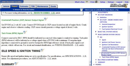

  • 75,992 POSTS
Try checkingthe CPS
https://images.2carpros.com/forum/automotive_pictures/12900_1998_cavalier_CPS_checks_1.jpg
https://images.2carpros.com/forum/automotive_pictures/12900_1998_cavalier_CPS1_1.jpg
