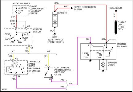

1997 Chevy Cavalier starter relay
1997 CHEVROLET CAVALIER
SBARTEN
Electrical problem
1997 Chevy Cavalier 4 cyl Front Wheel Drive Manual
location of relay
Feb 7, 2010 at 12:27 PM
BLUELIGHTNIN6
  • 16,542 POSTS
your Cavalier is not equipped with a starter relay..
https://images.2carpros.com/forum/automotive_pictures/261618_Noname_1612.jpg
