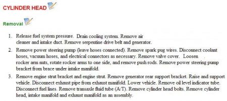

How do I remove the head from a 2.2 liter 1997 cavalier?
Sunday, December 13th, 2009 AT 2:47 PM
BLUELIGHTNIN6
MECHANIC
16,542 POSTS
SPONSORED LINKS
Sunday, December 13th, 2009 AT 3:58 PM
