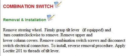

I need to know how to remove and replace the multi switch for the blinker and brakes with cruise control for a 1996 chevy cavalier. I have everything off but the bottom cowling. I removed the tilt lever but the bottom cowling will not come off so I can access the bottom screw of the multi switch. How can I finish this.

https://images.2carpros.com/forum/automotive_pictures/261618_Noname_2329.jpg
