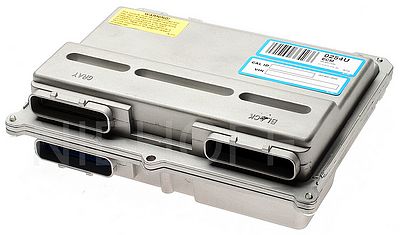

Sounds like you might of fried the Engine computer they are usually located behind the dash board, i would consider other options before going and buying new engine computer even though that's what it sounds like they usually cost between $100-$160 Computer
https://images.2carpros.com/forum/automotive_pictures/181828_ecc0254mu1_1.jpg

Trying to get back to work on this. Checked wiring again and found no problems. Sounds like a computer is next. My repair manual says that the home mechanic cannot install and program the computer and it must be taken to a dealer. Anyone know if this is true? If I have to take it to a dealer, the $100-150 will triple and I don't know if I'm willing to put that kind of money into it.

Yes its true you can not replace the PCM with out programming it
it has to go to the dealer

I know its a software issue( more then machine or an equipment) as GM will not release it so other have no access to it
I would make sure and be 100% sure its the PCM before I go for replacement
