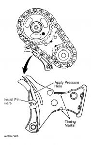

What are the steps to set everything up, IE when the #1 is at TDC what valves would have presure and what ones should Ths is a 2.2 liter and from the front i count valve from engine mount 1 2 3 4 5 6 7 8. I think the timing between the crank and cam are out. I have no compression what so ever on and cly. 1 2 3 4 nothing.

Hi There, Set valve timing as per pic, if you have rotated engine with the valve timing incorrect you may have bent valves. mark (mhpautos)
https://images.2carpros.com/forum/automotive_pictures/61395_Graphic_3.jpg
