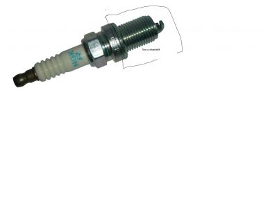

1995 Chevy Cavalier 4 cyl Automatic 122xxx miles
Hi I got this car the other day and was trying to change the spark plugs two cam out fine but 2 of them wont move. We tried taking them out with oil and lub everything. we broke the plug and not only the part that screws in is the only thing left and it's stuck and ideas on how to get this out no i have talked to knows. I really need to fix this car. It's the only thing wrong wiht it so i need it done and this car will a great one for my son's b day gift please email me asap Thanks.[img:4d2c16c58d]http://www.2carpros.com/forum/automotive_pictures/225759_untitled_1.jpg[/img:4d2c16c58d]

Hi there,
This is a nightmare foe a qualified mechanic, there are a number of broken stud extractors on the market but to use these you will have to knock out the ceramic core and drill to the correct size, you really have to pull the head off to repair this properly.
