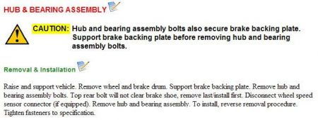

I can not for the life of me get the rear brake hub off to get to the rear bearing. Is there some sort of trick or is there something wrong with my hub?

Try these procedures. If hub is stuck, try pecking on it with a rubber mallet.
https://www.2carpros.com/forum/automotive_pictures/261618_Noname_539.jpg
